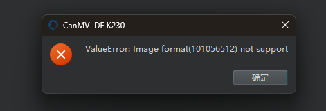

显示jpeg图片时报错 ValueError: Image format(101056512) not support
Viewed 159
代码:
from media.display import *
import time, os, sys, gc
Display.init(Display.ST7701, to_ide = True)
MediaManager.init()

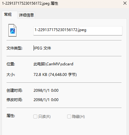

img = image.Image("/sdcard/1-229137175230156172.jpeg")
Display.show_image(img)
报错:
图片转成PNG格式同样报错
